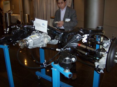

I don't think you should have any wheelspin before the RWD kicks in. The computer and clutches should react in less than a second IIRC. Also, just an FYI, the PTU runs 100% of the time and the RWD is engaged by a clutch pack that is attached to the front of the rear diff with the driveshaft from the PTU as it's input. It's the cylinder shaped case:
3547724924 c52e617260 b
BTW this also answers the question about The SHO's AWD system being a Haldex system, in that it's not. If you read the display card, it says it is built by ZF.
