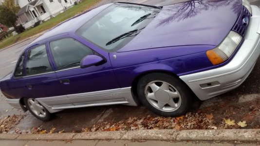

About 10 years ago I bought a 1991 Sho + with most of the usual mods (except having the heads honed). It came with Ford's black paint and peeling clear-coat. I had it repainted with plum crazy purple and silver. I store it in winter and have our local garage do most of the non-cleaning prep. I use 93 octane BP gas. Two questions: who makes the best tuning chip for a 91 SHO? and what is the best super-charger for this car? I don't race but enjoy what happens in 3rd gear, aka, the "Jesus Gear". SHO SIDE
