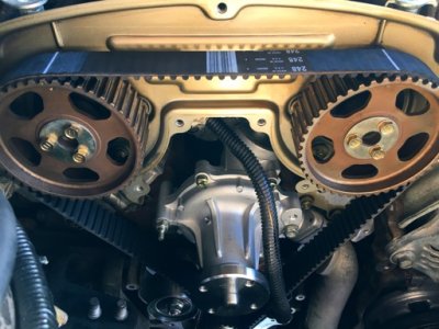

A thing of beauty. Making great progress. Should start putting videos together after buttoning her back up.
Spoiler...30 years old, 132k miles and no one has ever rooted around in the engine bay...all original and no leaks. Seems impossible...maybe it only has 32k miles? I’m dreaming.
