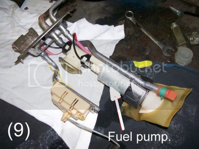

The sender is part of the fuel pump assembly. It includes the float and rheostat that the float arm attaches to. You can take your known good fuel pump and swap it into a fuel pump assembly with a known good sending unit. I'll try to take time today to pull apart a fuel pump, and see how "changeable" the sender unit itself is - as it can be changed in many OEM and some aftermarket fuel pump assemblies.
Here's an image of the entire assembly. The sending unit, is the beige box with the yellow wire-lead in the lower-left of the image:
100 1078
Where is the sender? In tank?
