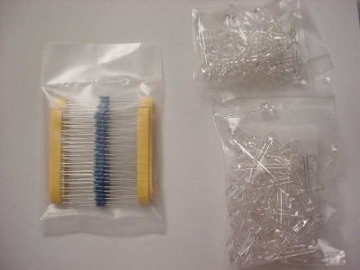

I think Fred is talking about stock socket LED's already mounted/soldered and ready for 12V DC power, the circular type.
Now these individuals/seprates are the other type:
Led
And my LED project continues... evil_gri
BTW Fred go with the resistor above to get rid of the rapid flash, thats how I solved my "Lamp Out" problem with these "G35 Tail Lamps" I started on.

The resistor you show is EXACTLY what I have, down to the blue clips, etc.
I just gotta figure out where to tap it into. :)
