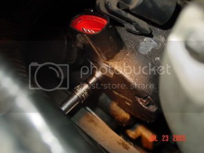

This would be your CID (Cam Sensor) causing your issues. I've had two SHO's that have done this, both were fixed by replacing the cam sensor.
Here's the cam sensor.
DSC01072
It's located on the passenger side of the car, towards the firewall.
