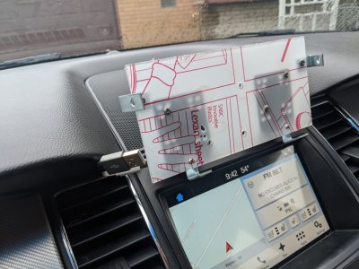

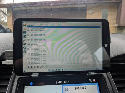

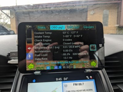

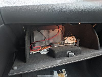

My tablet setup, using two Panavise phone mounts above the head unit, a sheet of Lexan, and 4 angle brackets. I have a similar setup in my GTP as well.
TabletMount Lexan
I suppose I could have removed the protective film from the lexan. But I never see it with the tablet mounted over it.

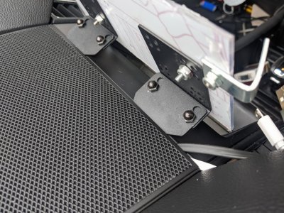

TabletMount Panavise

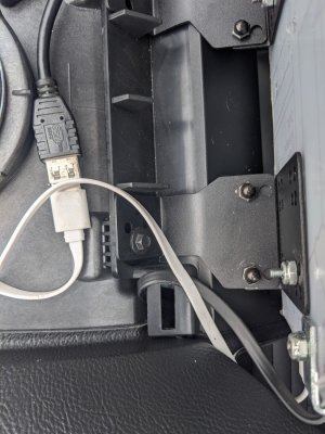

I used flat USB cables to sneak through a gap in the dash trim.

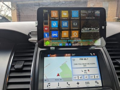

Tablet HomeScreen
The UI is a program I've been working on for a very long time.

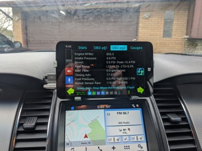

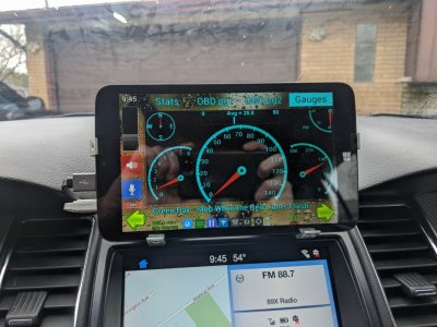

Tablet OBD Gauges
Tablet OBD 1 Tablet OBD 2
Lot's of OBD data. Using an OBD Link MX BlueTooth adapter.
Tablet FORScan
Yay FORScan
TabletMount GloveBox
USB hub in glove box. The hub is also a USB sound card, and audio runs to an adapter in the center console.

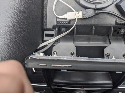

Under the speaker grille are two bolts. The Panavise mounts are attached there.
They are part # 75107-513
I did bend mine a little, to get the tablet at the angle I wanted.
TabletMount Panavise 2
TabletMount Panavise 1
One USB cable for power snakes down the left side of head unit, to a fuse tap near the driver's feet.
The other USB cable for the hub snakes down the right side of the head unit to the glove box.
There's a USB GPS puck on the dash near the passenger A-pillar, which also plugs into the hub.
I've been installing mini-ITX PCs and tablets in my cars for 15 years. I used to use a 200w DC-DC power supply and a quad-core AMD system in my GTP long ago, before tablets were a thing. I just added this tablet to my SHO last week, so the minor details haven't been cleaned up yet.
