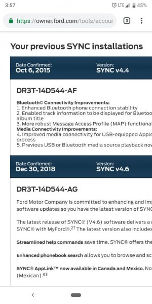

If someone who's had that update can log in and check Sync update history it should provide the OTA file name for that major update. Then I can search and see if anyone has posted it to a file sharing site. 2c805b89a72aac3b1bfd66ed59b47f0e

I have a 2018 SHO it was running a different version when I bought it but I am not sure what version it was and the site does not say. I just hooked the SHO up to my home wifi and it updated to this.
