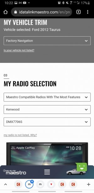

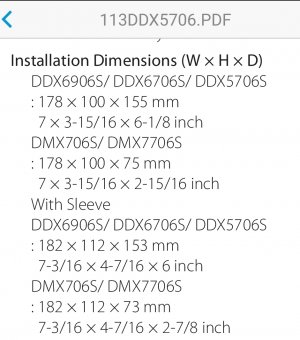

Ok, the video of the 2013 SHO is using a DMX706S....The DMX7706S seems to be the newer model. They're the same size and Maestro shows that they're both compatible.
So I think it's safe to say Crutchfield doesn't have all of the compatible stereos listed. F713fdc9bdfba9fee5eabc61fd55a3b779d0b815eda0baebf6275857e76b258d
