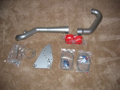

This is what I did to make my bracket work...
yamahaSHO
E85 whore
Jul 25, 2002
10,646
Arkansas
That one also raised the SC and bracket into the hood, IIRC. For low fitment, the extra hole needs to be on the far side.
