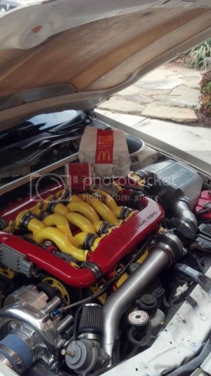

Another boosted SHO.
3.0L
Vortech S-trim 10psi
Air to Water Intercooler
BBB
Ported Throttle body
Equil Length Catless Y-Pipe
3in Exhaust
DynoMax Muffler
And a 75 shot

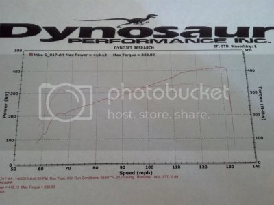

I laugh in the video because they asked me what I thought it would make and I said 375.
http://youtu.be/MZMeonvS8Dg
Made 374 on motor and 418 on the bottle
2ndDyno zps25c6e398
DampG zps529c1d4b
