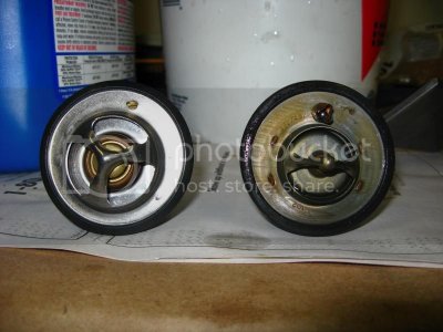

Install with the jiggle valve up. I use the Autozone thermostat, and it has been fine; nicely made.

192 is what factory installed. Both work well; I feel the 180 is a good choice for warm climates, and 192 is good for cold climates. I run the 180. The jiggle valve is in the ****** of the thermostat (see photos). It allows any air in the system to pass so an airlock cannot occur at the thermostat. Install with valve at at 12:00.
Duralast thermostat on left; Motorcraft on right

192 and 195 are the same for all practical purposes. The one on the right in the photo is the factory thermostat, and the 192 stamp is visible at about 7:00 position. I'm not familiar with what thermostats AA sells, but make sure it has the jiggle valve or don't use it.
