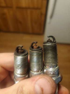

US
Just got the 4, 5, 6 plugs pulled, here they are left to right is actually 5, 4, 6, i ran like 20 miles home so thats why 6 is wet, 5 and 6 are the coils I think are going/gone38e6a52c64c4d7991378d6c1fc2c8fe0

swap the coils bank to bank. Same with the plugs. With them all removed you can do a compression test to rule out base engine.
Did you every retrieve DTCs?

Ok so the coils showed up, went to pull the 6 plug to check it again after I had done some tests the other night. Realized that it is actually covered in oil not gas.....so here we go, i guess ill pray its an o ring or gasket not a piston ring

Compression test and leak down tests sound to be in your future.
I was betting on an injector. Sad to hear its oil!

Did you clean off the plugs before you took that picture? If it was oil in the spark plug well your coil and plug would be wet, not just the electrode of the plug.
You could also have a intake valve seal fault if your burning oil along with a ring, piston, or cylinder wall.
When you say o-ring are you talking about the valve seal? I thought of that after my post.
A manual compression test and a clinder leak down are a heck of a lot easier than pulling the valve cover.
