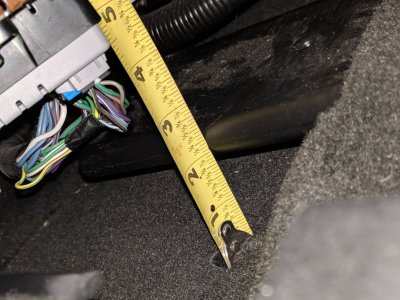

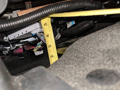

For anyone wondering about the Kicker Hideaway under the front seats, I believe it is possible but you'd have to cut this plastic vent. It measures 9 x 13 x 3 and that seems to be the only thing in the way. The seat should still have full clearance to move front and back. I wouldn't recommend anyone tall doing this as you wouldn't be able to fully lower your seat.
1st pic - however my wife had the seat, slid fully back
2nd pic - seat fully down and back. Seat or speaker would be damaged. Ba685728197bb23bb63497445fa4ef54F5e4ff9efcb5f63e6ed8dc21979d6f91

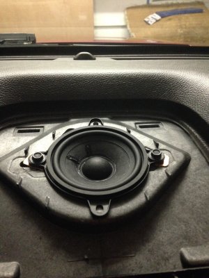

I also ordered 3.5” Infinty Kappa for the front and rear centers. Is this going to sound awful (is this signal processed by Sony unit)? Final piece will be the amped JL sub which will have to wait a few weeks. Play money spent quickly...
Center speaker is processed by the sony unit. I remember reading it’s a combined sum of L+R. not a true center only channel. The rear center gets the same signal wired in parallel hence the 8 ohm rating on the centers.
Here’s some pics I took a long while back.
Looking straight down from the windshield.
45b51d467a40e8042fe0b983ad156701
I have more picture but it’s not letting me upload them for some reason from Tapatalk

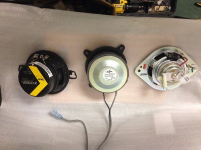

Factory center is the small shallow one
kicker 3.5” 2 way obvious win the sticker.
faitalpro 3fe25 4 ohm.
https://www.parts-express.com/faitalpro-3fe25-3-professional-full-range-woofer-4-ohm--294-1103
The last one is the one I’m using. The FR is extremely flat but it could us ALOT more on the bottom end.
I’m using it as a mid/high
