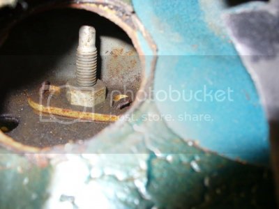

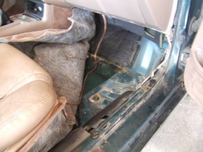

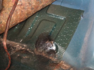

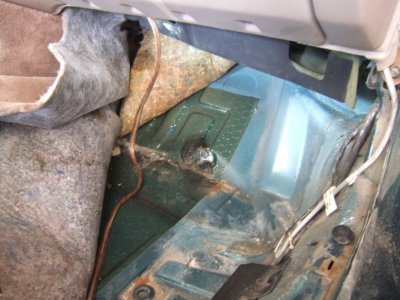

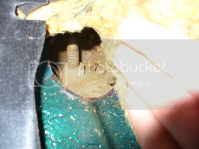

ive had plans on putting in asfb here really soon, and ive been woundering if i had the recall kits installed, i finally got to check, and i would like the experts opinion on this, it looks like i have the recall kits but they look different then all the other pics ive seen installed.
so my question is do i have the recall its installed.
passenger side.
P1010444
driver side.
P1010445

That's correct.
Depending on which state the car lived in, it may not have been a recall candidate.
