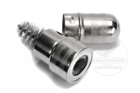

Going on with checking the connections for the pos and ground on the battery, make sure to clean and wire brush the terminals themselves. I've had similar issues before on my CVPI and all I had to do was clean the battery terminals and clamps with that special wire brush they make for that (sold at any parts store) and it was good as new!
18281 236805
The heat could be from increased resistance trying to make a connection through the crud on the terminals (depending on how much heat you're talking about).
