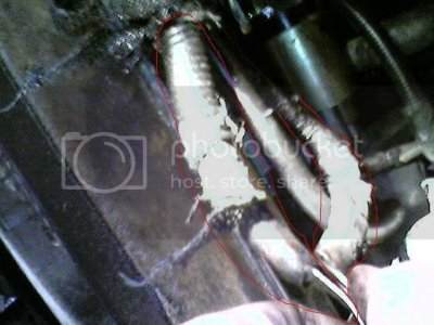

I'm almost done but I forgot where these two cables go. I thought they were together on the same bolt, but I still have two washers and nuts left. So they must be seperate, right? Where do they go exactly?
Sorry for the crappy cell phone pics.

they both go on one stud on the starter
not the one where the silver wired one is on the starter

They go on the solenoid. There's a braided wire coming off the starter that goes on the stud on the solenoid closest to the starter. Put a nut on that. The other two wires you circled both go on the other stud with the other nut. I assume you already know about the other little connector that slips onto a tab on the solenoid.
