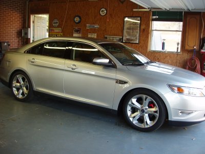

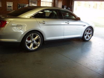

The car looks great Bob! Very nice job. Nice wax job too. That's the way it should have come. It looks like a mini lift kit is on it from the factory. Those are the H&R springs, right?
SHO U UP
SHO Guru
Dec 10, 2006
1,506
231
Virginia Beach, VA
Looks killer Bob! Fantastic stance it has. Thanks for the pics and keep it inside the garage as long as you can. The sun sure loves to fade some paint. Mine stays tucked away too for safe and secure keeping.

Looks really nice lowered, adds to the aggressive stance. How did you get those calipers so glossy, what did you use?
shobob
Dec 2, 2009
108
New Brockton Al
Just red caliper paint. If I do not upgrade the brakes to bigger one's when someone has them. I am going to take them apart and powder coat them.
