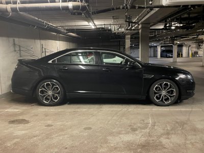

Hello all,
I recently installed H&R lowering springs on my 2017 SHO non-PP. The rear springs were installed with no issues and fight very tight. The front springs are loose and can rotate by hand.
Is it safe to drive with these springs?
H&R Part #51626.
Thank you in advance.

Their fine. Thats how mine are. With the shock off you dont have to compress them. Just put them on and then the top hat and the spring are loose. Once the weight of the car is on them they are tight and fine. Most performance shocks are like that. Every performance car i owned is like that.
