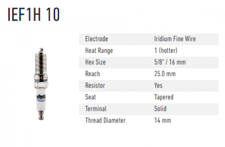

The Pulstar Iridium Plasma plug is a nice upgrade over factory plugs on my 2013 FIPS 3.5 EB. The spark is waay bigger with these plugs compared to any other plug I've ever seen or used because of an internal capacitor that generates a much higher voltage output (see video link). I'm not sure why nobody else seems to mention them as they are an obvious choice. Not sure how they would interact with a tune, but I can say for a car without a tune, they make a noticeable difference in performance. Just look at the difference in flame kernel propagation. Al Unser approved! :thumb:
1687901969165
