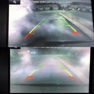

Just installed the camera, wow... I will post before and after pictures.
steelgiant5
Feb 22, 2015
343
159
2a5e30136ea1c76e4fb212fa0bf2163d
Top picture is new, bottom is old. Same place same time of day. Top picture it was wet outside though. Both pictures are in the dark and have exhaust smoke in them
