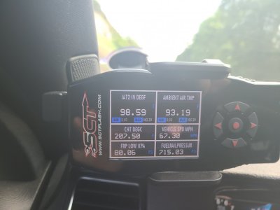

Hot day out. Testing a whole new intercooler setup. No meth. Water to air intercooler. I see around 5 degree difference from ambient. So on a 100 degree day it still would not cut back timing.
At highway cruise. On wot is goes 40 degrees below ambient
The max is still from the air to air intercooler as sct only refreshes the min max after you exit datalog mode. Even if you turn off the car for 2 weeks the max stays the same as it was

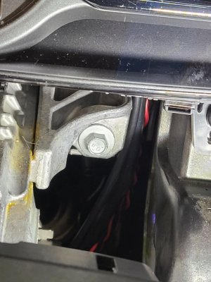

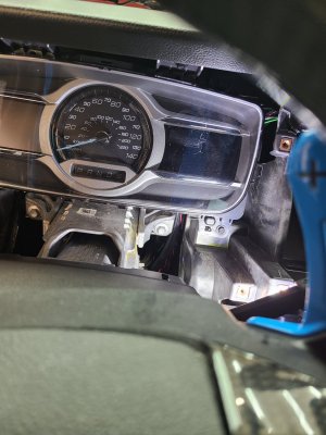

How was the gauge hookup routing? Just down the open dash areas to under the dash and through the firewall? Ive wanted it for awhile. Just never mapped out all a spot to fish the wires and hoses
It wasn't very hard, I took apart the dash just to get a good idea of where to run the wires. Basically it's a straight shot from the center speaker area down to the driver's footwell and then I found the rubber grommet through the firewall into the engine bay and then down to the corresponding sensors.
