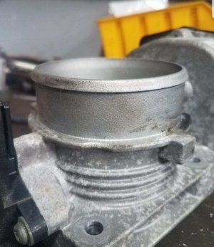

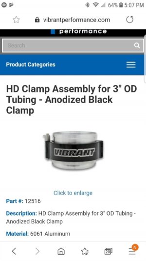

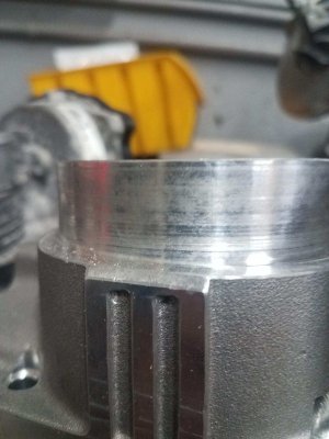

Remember on your BBK TB, they run upside down on our platform..... so you'll need to have a weep hope drilled and because it smooth ended, whereas the factory version has a "lip" at the end for mounting the Post-IC pipe, on the BBK you'll either need to consider having a bead welded on there, or consider using an alternate style clamp, such as the one below. Otherwise your pipe will blow off repeatedly.

Thanks for the tip on the BBK I can bring it into work and have one of the guys weld a bead around the Edge..
