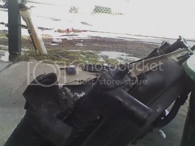

So i have learned its not easy to have a sho and not have alot of money lol i was wondering do i have a buy a fancy pants sho radiator or can i go to a j.y. and get a taurus one and if i go to the j.y can i use a atx sho radiator cuz all they have right now is atx sho's so there fore only atx radiators
The jist of my question is do all taurii have the same radiator if not which can i use:thankyou:

here is side by side of a sho vs slo first gen. there happens to be holes for the slow to bolt to and it will work but they are different. 01 07 07 141101 07 07 1410
