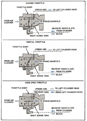

The valve-cover-to-throttle-body hose, for example, flows into the engine normally, but on WOT, will reverse and put blowby into the intake - a better place to add an oil trap can.

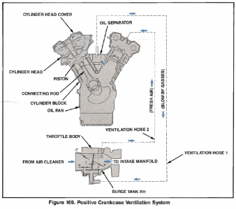

The SHO does not have an oil trap or catch can. All the suggestions here are about adding an aftermarket one to one of the PCV hoses - which should only be done if you actually determine that this kind of band-aid will rectify some other engine problem that you aren't going to fix the right way.
One instead has to apply some thought, and ponder what the mechanic might have done to make a previously perfectly-functional car smoke after doing a regularly-scheduled service interval.
Here's a couple images of the positive crankcase ventilation system, and the two hoses one might re-route.

The outlet from the front valve cover to the throttle body can actually pick up a decent amount of oil and blow smoke out the tailpipe if you suck on it (or if you have excessive blowby or the other PCV port is plugged up), from my various experiments applying engine vacuum to the crankcase.
