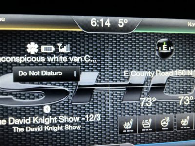

I bet M has never seen 5°!
IMG 6063
I was angry. Had to wake her up from her cozy hibernation to get me to work this week. Hauled in about 3 cords worth of logs and Farm truck retaliated on me with a broke a spring mount. Couldn’t get one locally so I have to wait for shipping.
Creaky, but M took it ok. The turbos were happy for sure but way too much transmission cooling for arctic temps. Full operating temp the trans was reading 108°. Loooooong shifts.
Hahaha too much trans cooling....I have never heard that before. I would just throw a piece of cardboard over the trans cooler. Maybe that will help? No doubt I would think she would be creaky and cranky.

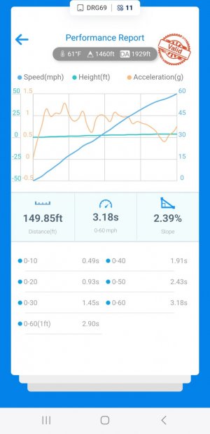

Fastest 0 to 60. Still having traction issues, but that is expected. On a better street, it should be faster.

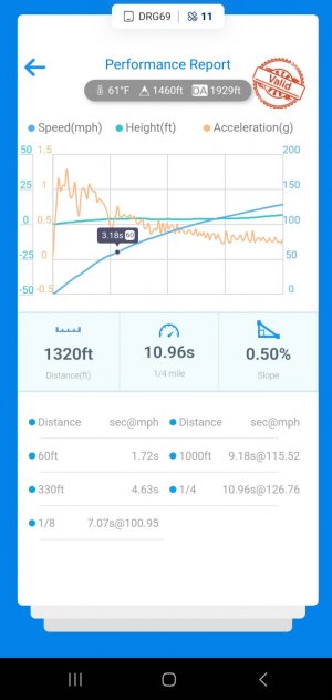

First 10 second dragy pass for Elizabeth. Car picked up in the middle for sure. Fastest 1/8 mile et and MPH. That carried over to the fastest ET and MPH. I still think it will go faster as it learns.

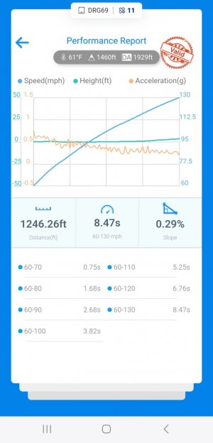

60 to 130 dropped another 2 tenths.
1000008203
So the CPC did what the Mercedes guys said it would. They said it would drop an ET .2 to .4 tenths, and add another 3 to 4 mph.
So for $3650 I got roughly a gain of 60 hp, and roughly 125 ft tq. That translated to roughly a .43 faster quarter mile and almost 7 mph faster. It also dropped the 60 to 130 by 1.55 seconds. Remember the faster you go, the harder it is to go faster...

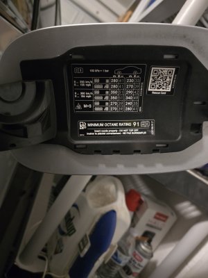

I plan on driving it a bit more and going back to the street in the next couple of days to see if it will go faster. Give it some more time to learn. Going to do my warm up loop and then straight to the spot. Send it with whatever tire pressures it has. I have been running them at 36 psi square. See if I can pick up a 10.8x pass at 127 mph +.
Next will be running a pass with Mercedes recommended air pressure settings. Below is the picture attached to my fuel flap.
20241207 153858
Since I am not running faster that 135 right now, I am interested in the 41 psi front and 33 psi rear. Once I find a good psi, I will run the rest of the test passes at those pressures.

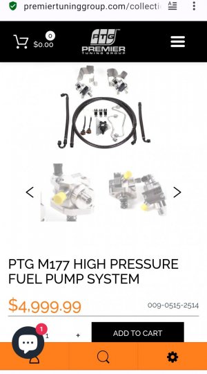

My tuner did say that after downpipes we will be officially out of high pressure fuel pump.
Dont fret....PTG's upgraded HPFP are only 5k. ‍
Screenshot 20241207 160454 Opera
I don't think I will go down that rabbit hole. I think a good 91octane tune and with catless dp's, and a good drag radial will net me a good 10.6x pass on the street.
If I want to go faster, I will auto swap the Lexus.

If I remember correctly you said that you would have put in a high pressure fuel pump a lot sooner in the SHO for all the benefit it gave you.
Do you think maybe it could have the same benefit in the Mercedes?
