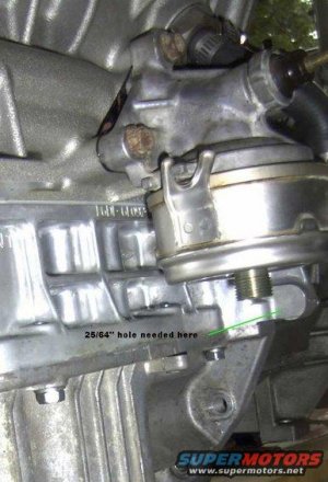

Don't forget the rear main seal. And there is an undrilled boss on the left side of the motor for a tranny bolt.
Undrilled boss w hi lite

Thanks for the info on the hole that needs to be drilled. I had heard about main seal but not the missing hole.
