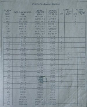

Here is a a chart with spring codes and spring rates. Try and compare what is available now with what came on the car new. Be advised all of the loaded stuts available for the Taurus use a soft spring rate.

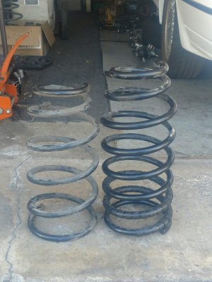

Here is more info on spring rates. Stock as well as aftermarket. Buy Quick Struts if you have to, but know that they have the softer SLO spring rates. Pic of front springs has a SHO on the left verified as 200 lb. per inch, SLO on the right verified as 155 Lb. per inch. So best to retain the current springs if they are original:

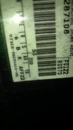

I was looking more into it and found the spring code on the door sticker. FFZZ. I found a part number for spring F, E6DZ-5310-F. I could look into getting custom springs for her, but what about the rest of the strut? Are those also different?
That said, does anyone know the proper dimensions and spring rate of those?
The PDF Bill linked shows 907 / 155 and 462 / 100. But I don't know the dimensions, or what other specs I would need.

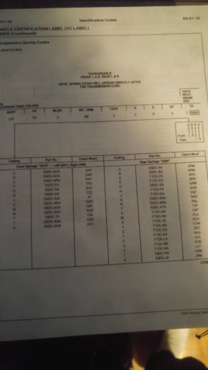

Ford had 3 letter codes. Z isn't one of them. The SHO uses the Heavy Duty springs. Also from my records:
Spring, front, code J (2)E6DZ-5310-AJ
Spring, front, code K (2)E6DZ-5310-AK
Spring, rear code J (2)F1DZ-5560-Z
Spring, rear code W (2)F1DZ-5560-A

Says Z right on the door sticker :p
That said, still looking for a custom spring maker for the fronts.

Just got the new springs in and of course they are not the right size. At least I don't think so.
Just to confirm, I think I know the Ford numbering scheme, but E6DC-5310-FA and E6DZ-5310-F are the same, correct?
