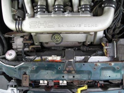

I am going to be replacing the radiator in my 94 ATX before the winter comes. I have been looking at prices and have found they run around $170 local. SHO Source has the replacement for $164.00 and RCM has it for $119.00. Has anyone used RCM's radiators? If so, how is the quality?
Here's what a RCM dual core radiator looks like in an ATX. I lost a lot of sleep trying to cram that radiator in there. If you need help, shoot me a message.
