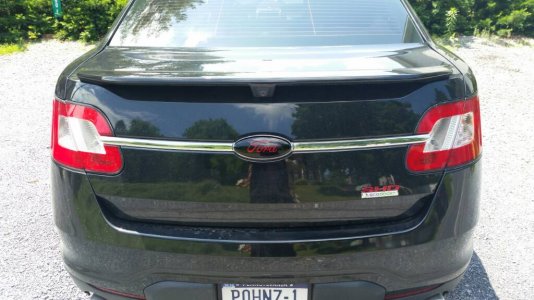

Here's what I did. Likey or no lilkey??...
Hi Omahahn, Nice SHO and I really like your emblems!
Would like to find a set like yours. Can you tell me where you got them?
Thanks!

Thank you!! Updated rear end...
I got the emblems on eBay! Just do a word search. Have fun!

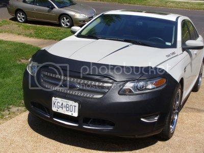

devin:
you read my mine, except on front, bra is at the seamstress now. if it turns out like i think it will, it should be something & manu thanks once again for getting my head straight. hope you like the bra, didn't go over board. maybe you can guess. the way i got it. hope for end of week but guy was real busy. & you can tell a guys real roots when there's a 2002 stratus r/t behind the sho. only 2nd ford i ever bought but she gets the garage & the 2 mopars sit outside.Bra050315 zpsllzgxlcw
Where from in MO? I am near St Louis, Fenton Valley Park area.
