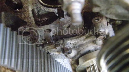

Issue found
100 3325
someone wanna tell me what's wrong with this picture???? :|
The grinding was the starter skipping teeth across the fly wheel because the engine jammed up when the bolt holding the tensioner snapped and the belt jammed up everything....
How in the **** am I going to handle this???
