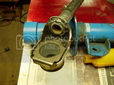

One thing that I just found with the 92, is that inside the shifter box, that there was alot of play where the shifter cup attaches to the transfer rod, the factory crimped connection was loose causing the shifter to move side to side alot more, and forwards and back, removed hte shifter and rod, welded the crap out of it, and there is no more play there any more.
