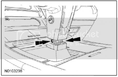

According to the 2010 and 2011 Factory Service manual:
1. Slide the selector lever **** bezel down to access the 2 selector lever **** screws.
2. NOTE: If equipped with a Transmission Control Switch (TCS), do not pull the selector lever **** off of the selector lever.
Remove the 2 selector lever **** screws.
Vehicles equipped with paddle shifters
3. Remove the selector lever ****.
2011TaurusKnob zpse115e595
