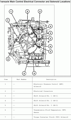

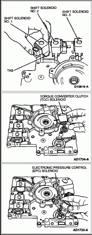

I found this in another thread. Can these instructions also be used to get to the other shift solenoids?
Break the ball joint to push the left front hub towards the drivers door in the wheel opening.
Remove the inner fender.
Support the tranny from below.
Remove the cross member/support from the drivers side of the transmission.
Remove the side cover of the transmission.
Replace the TCC solenoid
Put everything back together.
Top off the transmission fluid.

Did you try to post a couple of pics? I see red x's. I know I have seen pictures of the solenoids before and have searched, but haven't found them yet. I am thinking I could change out the 1st or 2nd shift solenoids and see if that fixes the problem.
