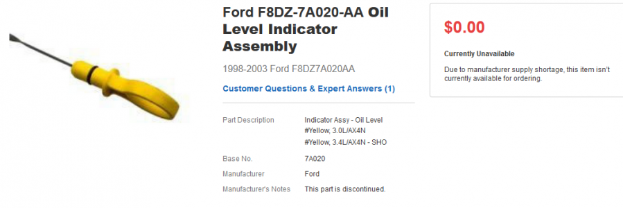

Does anyone know how to get a Transmission Dipstick for thier '96/'99 SHO? I do not have it available at O'Reilly Auto Parts and the SHO I just bought doesn't have one. I did not see one on RockAuto as well.

I would have to believe that ANY AX4N dipstick would probably work. And there are plenty of regular Taurii in yards across the country with AX4N's in them.

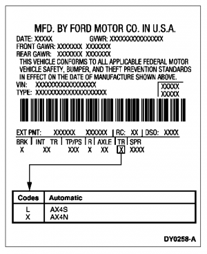

You're looking for transmission code X. Probably also used with the 3.0 DOHC engine. Also, Mercury Sable used the 3.0 DOHC.
