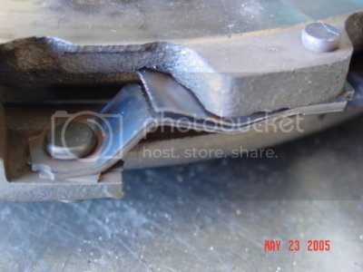

you may have broken or bent a strap...
is there a rod shifter in the car???
sounds like the problems that i had...
i have a thread that has picks on what happened....
i'll post it up here...

Im going to have to say, a bent strap....
i know i bent and broke my stock PP straps....
let me get the pick....
just take it easy.. i was there... plenty of times... but, atleast we have an idea what the problem might be... which im almost 100% sure it is...
be back in a few with pics...

thats what mine looked like... and was doing the same things you described... you should be able to get it in to gear... but it will put some strain on the trans... :eek:
sounds like a new clutch bud...... sorry...

Update
:UPDATE:
PP strap huh?????????
I dont think so.....
Ill post pics later. Strange failure.
Right now I need to find a new disc :madflame:

I thought I was the only one who ever did this. Although my springs (the same ones that are out on yours) completely popped out and were rattling around inside the bell housing. As to the cause I would have to say a super harsh downshift or a faulty clutch. Being only 20k on it I would say faulty clutch. Mine had about 75k when it did it. I wasn't even driving when it broke Tireman broke mine when they were "test driving it" to see if they could do an alignment. I was quite ****** for awhile on that one.

It chewed up the PP pretty bad from the backside. The backside of the fingers have a nice ring ground into them. Another item for the scrap pile.
