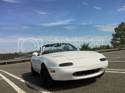

so step one to my plan has started,
Step one: Buy a miata.
 EF45 4F0B 9EE6 180BD0F7A7D4 6743 0000026B291C3F2E
Traded my supra for it, has 120k on it, paid $500 for my supra, got $200 on top of this Total cost so far $300 :D
Step 2 will have to wait till next spring because thats drift it till it blows up lol

I think that SHO motor will be a very tight fit in the miata. best wishes and looking forward to seeing it in there!
