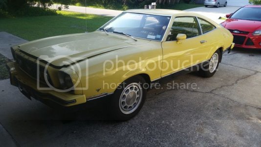

The Mustang II's mostly were not popular.
I always liked them, especially the Cobras or the King Cobras.
This will be an excellent vehicle when finished.
Power Surge
Apr 14, 2007
608
27
Palm Coast, FL
I like the less popular Fords. Mustang IIs are one of my favorite cars. I've had almost 10 of them now, including a 78 I put a supercharged Lightning 5.4 into.
7,521
OMG, not only is it a MII but its a canary too!
