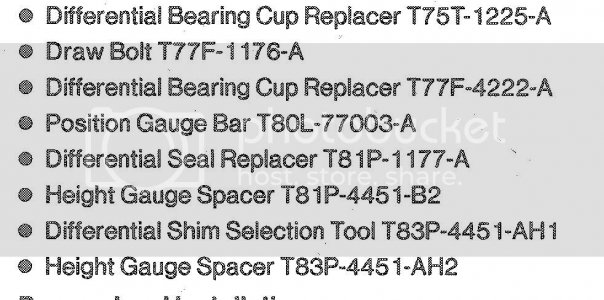

I want to use one , and I can borrow one at the Ford dealer , I wanted to know what part number (of the box) I need?

Sdaf
hope this helps?
You also know you need the 2 case spacers (listed as height gauge spacers) too right? which are in 2 different kits. The diff bearing installer is also nice to have.
