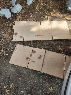

I'm burning a bunch of oil. No real puddles, although I definitely have built up dirt/oil under the engine, and I know the oil level sensor gasket is leaking a bit... but I am putting in about a quart every 500 miles or so. I park in gravel, but I don't seem to leave puddles. To me it seems like rings. What are the other options? Is there a way I can tell?

Do you park in the same spot every day? If so you can put some cardboard uner the usual place and see if you are leaking to the ground.

I am getting some smoke in the morning. But I also get some while at stop lights. It is very possible I have leaking valves, stuck rings and various block leaks.
