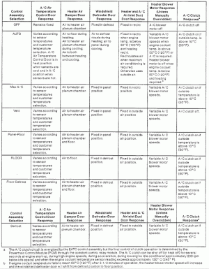

Well one thing to keep in mind is that there may be differences between years and locations sold. In my case I have both a California and Arizona sold car. Both do not cycle the A/C in the vent and floor positions.
Having said that AllData wants to confirm what you believe to be true where the clutch will engage when temps are above 10°C/50°F:
199620SHO20RCC Conditions zps6rq8tb3o
Though this breakdown doesn't take into account what temperature you are trying to output, as I think it's gear towards if you are intending to cool. In my case, if I am trying to heat on floor then I get no clutch. If I am trying to cool on floor I will have engagement.
A little further down in the "Operation and Description" shows "Manual Override". This means you have pressed one of the representing buttons rather than just leaving it on "auto" or MAX.
VENT
Pressing the VENT icon button will show the VENT icon and the set temperature in the display window.
  • The system will operate with outside air in the vent function.
  • The A/C clutch will be turned OFF.
FLOOR
Pressing the FLOOR icon button will show the FLOOR icon and the set temperature in the display window.
  • The system will distribute outside air through the heater outlet floor duct with a small bleed to the A/C side window demister and hoses and the windshield defroster hose nozzle.
FLOOR & DEFROST
Pressing the FLOOR & DEFROST icon button will show the FLOOR and DEFROST icons and set temperature in the display window.
  • The system distributes outside air equally between the windshield defroster hose nozzle and the heat outlet floor duct with a small bleed out the A/C side window demister and hoses.
  • The A/C clutch will operate if the ambient temperature is approximately 10°C (50°F) and above.

OK, that is very interesting. I have not used the SHO in a month so it is due for a ride anyway. I will take it out tomorrow and try the settings above. Forecast is for 10C, which is in the temp range listed. I will set the interior temp to 20C, which is, IIRC, about 68F. I can report back on Tuesday morning with results, I suspect.

Well, I am afraid I am not going to be of any help with this. My AC is so dead it seems the clutch no longer engages no matter what setting I am at. Sorry. It remains my memory it only did not engage before when on vent, but that is only memory and it from some time ago. Many years being the last time I messed with it. So, not really trustworthy.
