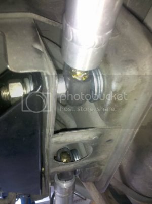

Here's more pictures of the control arms coming together. I've got neighbors living directly above my garage, and I doubt they'd appreciate my air ratchet blasting at 1am, so work continues tomorrow morning.
It was recommended that I grease and seal the ball joints of the Zach Leahy aluminum control arms. First a liberal coating of grease:
2010 05 01105308
I found some 1.5" heat shrink for $50 for 4 feet. Over a dollar an inch! But less maintenance is worth it in my book. I shrank a small piece on the end of each, and drilled a hole back through the tubing and ball joint for the bolt to pass through:
2010 05 01112442
Before and after greasing and sealing:
2010 05 02010355
New control arm versus old control arm:
2010 05 02010529
Found a short drill bit while browsing Harbor Freight Tools. Yay! Don't have to drop the fuel tank!
2010 05 02011031
Can't wait to see this all assembled on the car. Hopefully I can finish it tomorrow morning. I need to finish the battery, and get back to the engine.
