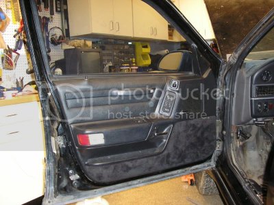

I started putting some of the new interior in, all cleaned up. It's reminding me that all this work is actually worth it . . .
LFDoorPanel

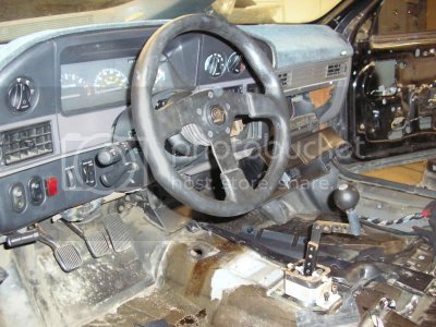

I assembled the new GT steering wheel from my old Aerostar and set it on the steering column to get a feel for it. I think it matches the dated interior well.

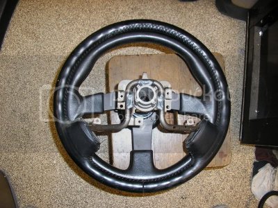

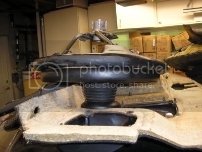

I'm going to have to scrap the old steering wheel and use the mounting hardware from it on the new wheel. My Dad knows a skilled welder that should be able to fab this for cheap. You can see how much smaller the Grant wheel is in comparison:

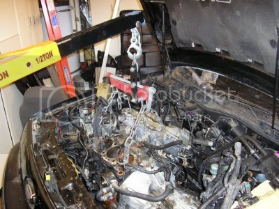

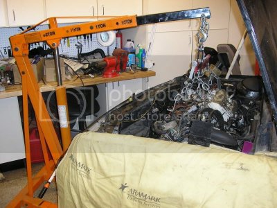

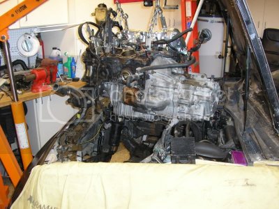

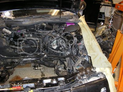

Aside from the usual small coolant and power steering spills, the engine came out smoothly:

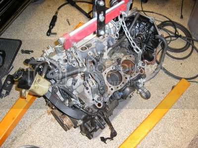

Now I just need to strip everything off the old motor . . .
Oldmotor

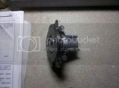

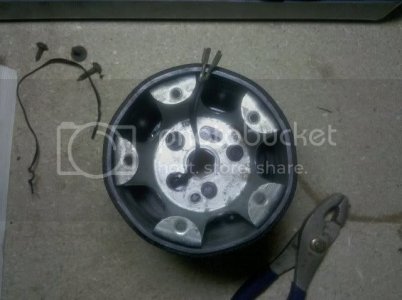

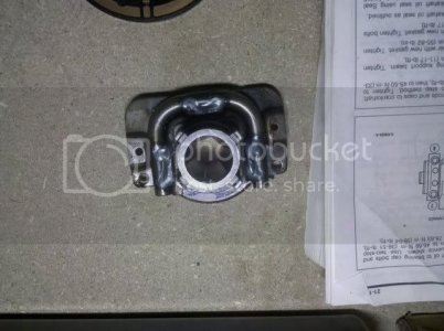

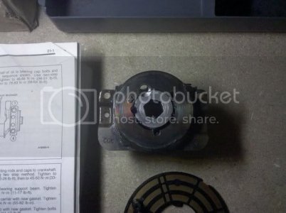

Today, I went to a local welding and machine shop to have my steering wheel mounting hardware fabricated. $80 and about three hours later, we had cut up the stock '89 wheel, and used it's hub as a base for a custom mounting adapter:
CustomSteering3
CustomSteering2
CustomSteering1

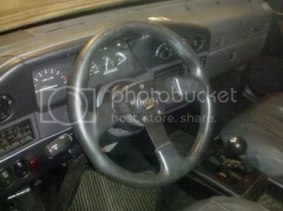

I got it installed in the car, and it's about 90% complete:
CustomSteering4
CustomSteering6
I just need to wire the horn (I need to figure out which leads are for the horn, and not the cruise control), fill in the gap between the column trim and adapter trim ring with some scrap rubber, and re-align the steering shaft a notch.

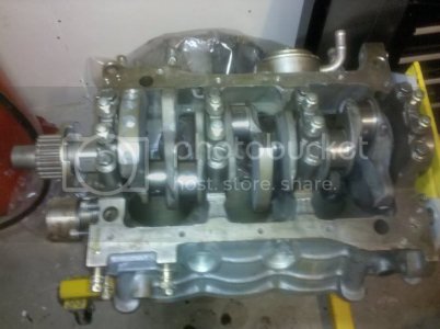

My new main bearings showed up today, and so I cleaned the cylinder bores with carb cleaner, some medium steel wool (there was a teeny bit of surface rust, and applied a film of 50 weight racing oil to the machined surfaces. Then I installed the fancy shmancy balanced and gas nitrided crankshaft:

Since you used steel wool to clean the cylinders, it might be a good idea to rub a strong magnet all over the inside and outside of your block.
You didn't remove the cross hatching with the wool, did you? That's bad. Cross hatching catches oil for the rings to slide against.

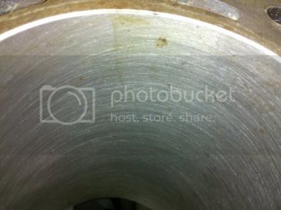

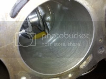

Here's some closeups of the cylinder walls:
2010 03 11195756
2010 03 11195733
There's some mild hatching pattern, but I know I've seen more prominent hatching on fresher (0 mile) blocks. Is this sufficient, or should I try to hunt down a ball hone? I don't know what you mean by any "general supply" store. Home Depot? Autozone?

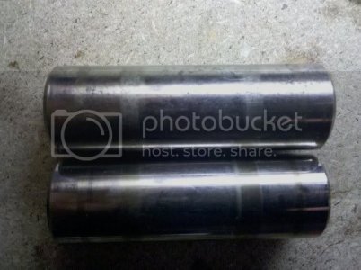

And two of the wrist pins have a little bit of roughness to them. It's very visible, and only slightly noticeable by touch. I've tried polishing them down with a polishing wheel on my Dremel with some success, but still not perfect. Any suggestions as to how to clean these up? Buying a whole new set of wrist pins is not something I want to do. Maybe a machine shop can clean them up for me? In the picture below, the upper pin is slightly rough, and the lower one is perfectly smooth to the touch. You can see the difference in the highlights of the pins:

Well, the cross hatching is way too "flat". There is a certaing way to do it that yields 45 degree patterns. With a ball-end hone this is accomplished by always moving the hone in or out of the cylinder at the sme speed as the hone is rotating. It's a difficult movement to make because it's more natural for us to "drill that sucker" clean with the drill on high speed. Cross hatching is not for making the cylinder smooth, it's for making the cylinder rough so that oil sticks to the grooves.
The wrist pins look fine; but how do they "mic" out. Little pits like that are not a problem unless the outer surfact has started to come off. Mic them to make sure they are not ovalized.
