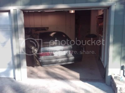

With garage space secured, I grabbed my brother to help me push the poor black Taurus back from the farm to our garage. It was less than 1/4 mile and mostly downhill, but still a workout!
Geeksho1

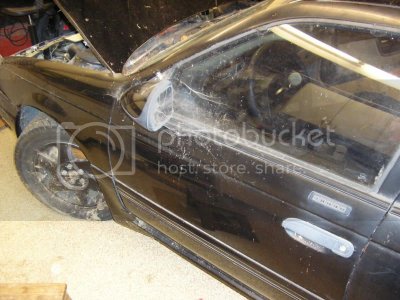

Finally made it into the garage, but the car is a mess:
Geeksho2
P1010052
P1010053
P1010060
Here's a quick Photoshop quasi-panoramic of it in the garage. The car is just too large to fit in straight, so for more room, it sits diagonally:

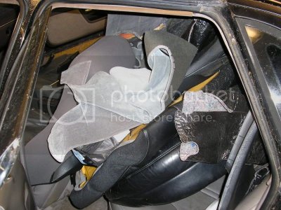

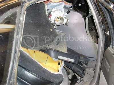

The interior was packed full of parts. Mostly its future interior parts and the old Eaton M90 bits:
P1010062
P1010063
P1010054

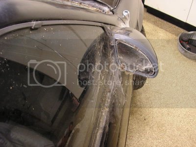

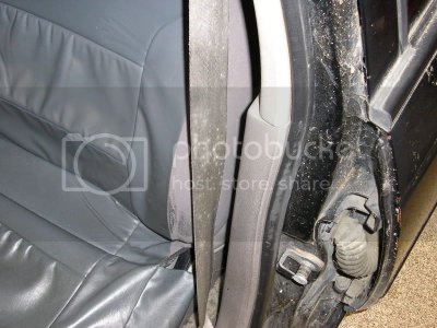

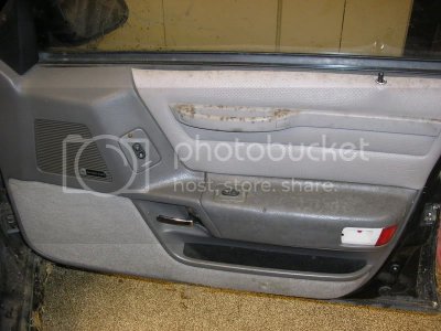

Three years has allowed some mold to grow in places:
P1010055
P1010061

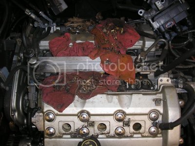

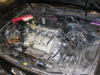

The engine bay was a mess. Spider webs and nests all over the place. It looks like rats made a nest as well, leaving acorns in the battery box and turds on my intake port protector rags. You can also see here how far my disassembly got three years ago:
P1010057
P1010059
P1010058

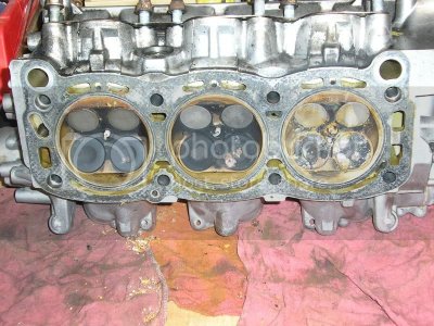

And finally, I finished getting the head off tonight:
P1010066

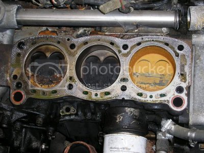

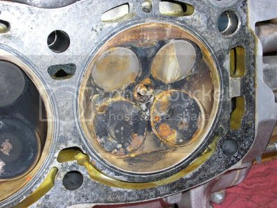

Closeup of the #6 cylinder:
P1010066
Front head:
P1010067
The #6 looks particularly nasty:
P1010068
I haven't worked on this engine for probably almost five years, so I don't know what's best to clean out the rust without damaging anything. I shot some WD40 to let it soak. Any tips other than just elbow grease? Does this look like a particular problem to anyone?
Maybe I didn't properly install the head, and coolant leaked in. Thoughts?

I've got to agree with HRK on this one. Even if you found that the original problem was something minor, once water has sat in a cylinder for that long there will be pitting of the cylinder walls. That will require a complete tear down and bore job. Not worth it IMHO when you can get another engine from the junk yard.
Tom
Sho Amo
SmkTyresntDrugs
Feb 23, 2006
3,299
856
Olney, Md
Yeah it looks like some coolant had gotten in there and over time it rusted. Good luck on the project I'm lookin forward to seeing progress.

Thanks for the tips, guys. That makes sense that rust has ruined the cylinder. If I can scrape the funds together, I would *really* like to bore it to 3.3 (who wouldn't?). If I went that route, I would consider lowering the compression a little. I'd love to put a turbo in this car down the road, and already have a few parts towards that like hot-pipes, injectors and a 255 lph fuel pump. Since I'm not looking for more than 450 hp, I might be able to just keep stock compression. But enough bench racing.
The more likely, and way less fun route, would be to just drop in another junkyard 3.2. I will keep updating as I work on the interior.
