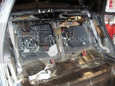

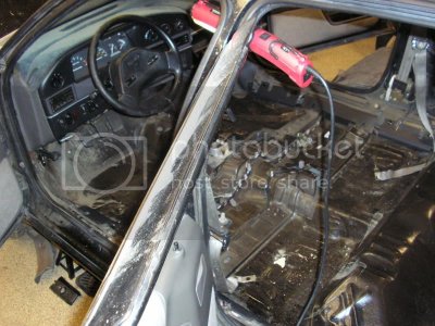

My blue car is on hold for the moment, so the black car got some more attention on the interior. A couple days ago it looked like this:
InteriorWIP1
InteriorWIP2
I think I like the look of no center console. Kinda old school muscle car-ish.

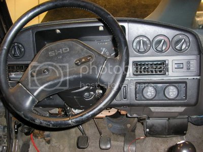

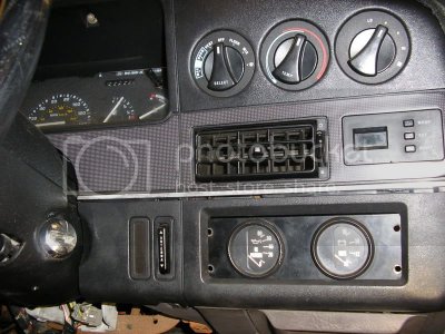

I removed the stereo deck and test fit a DIN sized gauge panel I found at the Pick N Pull on a '92 SLO:
GaugeTest1
GaugeTest2

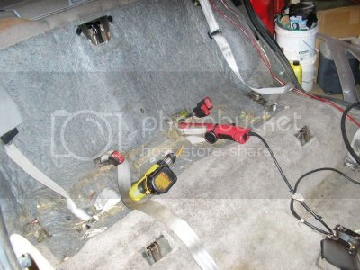

This is how far I got yesterday:
InteriorWIP3
InteriorWIP4
InteriorWIP5
Any tips for removing the tar layering the floor of the car? Heat gun and a scraper? I never knew my car had rear foot-well heater vents. Was this a common option? I think I'll leave it in because it's just a big piece of plastic. I'll save weight elsewhere.
Stay tuned for pictures of the huge trove of treasures I found underneath all the carpets.

a heat gun and scraper was used on James 95. but it didnt amount to a lot of weight

Dry Ice and a real big hammer...It will fall apart
