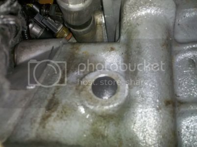

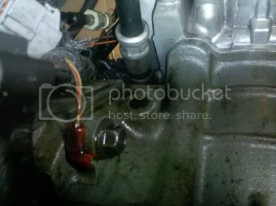

Still being lazy with the pictures, but all energy is being put into the car, not pretty pictures of it.
HOWEVER, it is RUNNING for the first time in four (4) [FOUR!] years! However again, it is leaking oil, and I'm pretty sure I know where. Unfortunately since I don't know a SHO block quite like the back of my hand, I did not notice that there was a plug in where the fuel pressure switch should go. This plug does not have any way for any bit to interface with it (I will take a picture tomorrow). It's totally smooth and flush with the block, and it is leaking oil badly. Maybe I can get it out with a pick and a magnet. I'm worried I might have to drill a screw into it to yank it out, which would mean possible metal shavings in the oil galley. In an act of desperation, I gooped some two-part epoxy on there to band aid it (and make it to an exhaust shop before they closed), but it lasted about 10 seconds.
Nick, did you put that plug in there? Any clues how it might come out? Again, pictures should be worth exactly 1,000 words here.

I solved the plug problem. Nothing like a little healthy paranoia. It was just a plastic plug that was clipped in. I'd think that something that small would have popped out just from the oil pressure, or when I was picking at it with picks. Once I hit it with a small drill bit, it popped right out.
