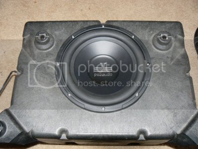

I am really enjoying that Polk Audio DB804... you need an amp tho, and must cut like the others said here....
Plus its the perfect size..
polk audio 840 8" rated @ 180 RMS...
Electrical
Overall Frequency Response 30-200 Hz
Nominal Impedance 4 ohms
Power Handling (continuous) 180 w
Power Handling (peak) 360 w
Efficiency 85 dB
Voice Coil Diameter: Driver 1-1/2" (3.81cm)
Driver Mounting Depth
Top Mount 4" (10.16cm)
Bottom Mount 4-14/25" (11.58cm)
Cut-out
Driver Cut-out Diameter 7-1/4" (18.41cm)
Thiele/Small Parameters
Recommended Enclosure Sealed/Ported/Bandpass
Resonant Frequency 49 Hz
Qms 14.1
Qes .6
Qts .6
Vas .42 cubic feet/11.9 L
Cms 157.6 Micro Meters
Bl 10.3 Tesla Meters
Sd 35.65 sq inch/ 230 sq cm
Xmax (linear) .51 inch/13 mm (peak to peak)
Mms 67. g
I found it easiest / fastest with a 4" angle grinder.. :) That box will melt away in no time, cut right around where the lip starts to taper inward and it's right about the perfect size for an 8"
P1080672
http://www.shoforum.com/showthread.php?t=111880
