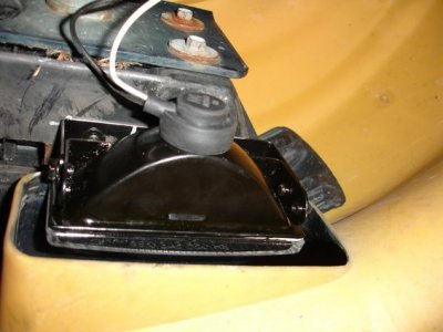

On my '93 I did away with the entire unnecessarily heavy brackets with pilot foglights.
Dsc14582
Dsc14590

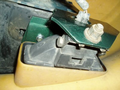

On my '95 I just trimmed the brackets and used the stock lights.
P1010008
P1010004
P1010005
