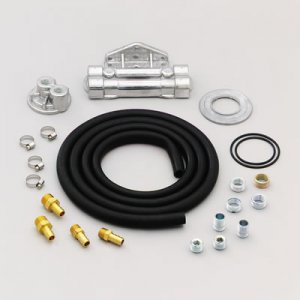

Looks to me like a SUM-4986, $50.95 + shipping:
http://www.summitracing.com/parts/SUM-G4986/
Just a comment or two on this kit. Beware, as these low priced kits often use small bore hose and restrictive fittings. If you're going to go to the trouble of using a high-flow dual filter, it needs to be on nothing less than -10 (5/8" ID) lines.
Additionally, I've looked at some of these low priced takeoff adapters and remote filter mounts and they are the crap-of-the-crap of castings. The internal passages are often rough and full of casting flash, they're just junk. This is actually one of those situations where you do get what you pay for, and there's better stuff out there - Mocal comes to mind.
