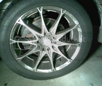

I've been getting a few *** here and there asking questions about my setup and I have not been able to respond. I'm sorry for this, but I will soon have it tuned and dyno'd and the whole turbo kit will be put out here for the forum to see. I've got drag radials and new rims on the way as well as a 13" brake upgrade sitting in my back seat. The only things I want to do to the car now are a wideband setup, re-do my intake piping(air filter setup), and finish the exhaust work(turbo downpipe and add a flex pipe).

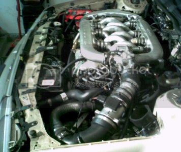

the whole engine bay

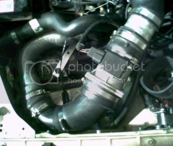

The new turbo piping in place of the old intercooler
as soon as I get a chance, I'll put the car up on the lift and take some shots of the underside to show the routing of all of my piping and such. The only thing I'm waiting for to install the 13" brakes is banjo bolts. As soon as I get them, it'll go on the lift and I'll take some shots of the undercarriage.
Also, keep in mind that some of the stuff on this car still needs to be taken into the exhaust shop(for a flex pipe, a few mandrel bends and such.) som the pipe that is in place of the intercooler is not permanent
